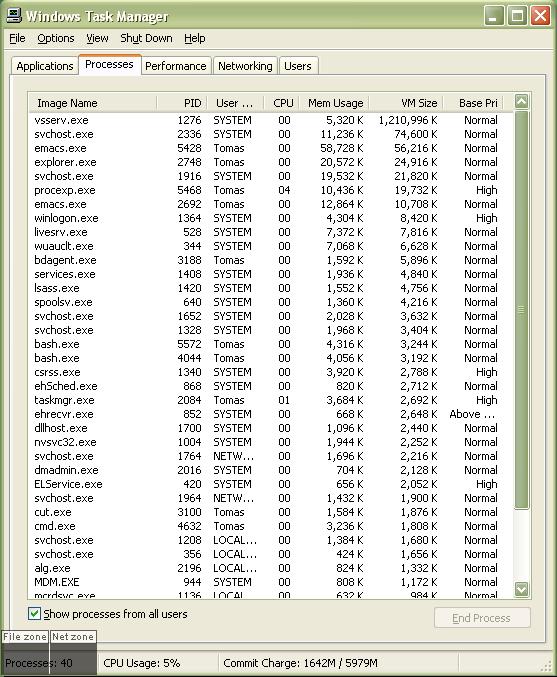

BD, for me, just didn't seem to be a good fit when using larger applications and needing to switch between them constantly. My typical programs open are InDesign, Photoshop, Internet Explorer, Excel & Outlook. I'm also typically switching from one program to another multiple times to grab photo's, pdf's, make modifications, insert into documents, etc.
I am having the same exact virtual memory problem that Xavier311 is having here with version 11 (2008). I frequently use photoshop , indesign, and illustrator at the same time, switching between them and other programs as well. With v10 I did not experience this vsserv VM problem, but other problems forced me to upgrade to v11.
I have been monitoring vsserv for a couple weeks and have done full uninstall/reinstall, and set BD to only scan application files, however I am still experiencing this Virtual Memory leak. In an extreme case where I was determined not to restart for a while, vsserv.exe exceeded 1.5 Gig of virtual memory, at which point my 4 Gig memory system was fairly useless. (no I do not have a screenshot, and it would be a painful week+ to recreate)
I have been putting off upgrading the other 7 computers I have BD licenses for until this issue is resolved.
If it's not resolved in a timely manner I'll have no choice than to look for suggestions of other options. Such as not having a security suite, but different programs providing antivirus, firewall, spyware, etc. Earlier in this post Sm3K3R suggested that BD is the best option for the antivirus portion of this solution.
To my mind, this multi program approach seems like a good fit for the tech savvy, heavy computer users.
I appreciate all the time and effort that goes into coming up with solutions, especially amongst negativity.
-BJ0 -
And how exactly can you bypass a memory leak (except closing and restarting that application)?
I meant by rebooting the computer.0 -
Hi Cris,
My BitDefender typically used a small amount of physical memory as yours does (3-5MB). As you see though, it's the virtual memory that creeps up over time. For me it started at 60MB after boot, 140-180MB the next day, 260MB the day after that, and so on. If your average reboot time is every couple days, it's probably not noticeable. When it starts getting up there after 3-4 days though, programs like InDesign, Photoshop, and even IE7 will crawl. When you start seeing your virtual memory above 1.5Gb, you begin to wonder why half of it is being taken up by your Internet Security.
When this first started occuring, I figured maybe it was the anti-virus portion of the program scanning the files I was using in the Adobe product line. When I ruled those out, I thought maybe it was something with Microsoft Outlook (as it checks for email once every couple minutes). When that didn't pan out, I used the system monitors provided by Microsoft to "watch" the processes as they're used.
This began the disturbing part. With no other programs open, I watched as vsserv.exe slowly used up more and more of my page file. From there, I disabled the anti-virus portion to see if that was the cause. Nope. So I re-enabled it and disabled the firewall. Nope. So I disabled all of the functions of Bit-Defender (while still leaving the program itself running). Now this is the kicker... it was still utilizing more and more virtual memory. I was left confused as to what in the program was still running, and what information could possibly be stored in VM with all functions of BitDefender disabled. (Again, this was done by unchecking all functions in the advanced settings)
I'm looking forward to seeing what they come back to you with as a possible reason. Thanks for your continued help!0 -

Looking through old logs and comparing all the data I'd gathered in the past - the problem that was causing the memory increase in vsserv.exe was the following. (This was found by using SysInternals Process Explorer & Process Monitor)
It performed this action every 10 seconds, and each time it did so, 28k of Virtual Memory was used. Over time, this grew the page file to the #'s that I've presented.
Instead, on some occassions, it did a ton of operations to:
C:\Program Files\BitDefender\BitDefender 2008\fwrules.dat
C:\Program Files\BitDefender\BitDefender 2008\pcontrol.ini
Basically creating, writing, cleaning up, closing, creating, reading, cleaning up and so on and so on... again, every 10 seconds.
Excellent sleuthing Xavier. This prompted me to check this out with ProcMon myself, and I found a similar correlation when analyzing the Process Monitor log:
$ head -1 Logfile.CSV
"Sequence","Time of Day","Process Name","PID","Operation","Path","Result","Detail","Command Line"
$ egrep -v '(("Reg)|(procexp.exe))' Logfile.CSV >| _Logfile.CSV
$ cut -d',' -f6 _Logfile.CSV | count-it '.*' | head -10
"C:\Documents and Settings\All Users\Application Data\BitDefender\DTrace\livesrv.log" 1538
"C:\Program Files\BitDefender\BitDefender 2008\pcontrol.ini" 720
"C:\Program Files\BitDefender\BitDefender 2008\Lang\l_bdagent.ini" 144
"C:\WINDOWS\WinSxS\Manifests\x86_Microsoft.Windows.Common-Controls_6595b64144ccf1df_6.0.2600.2982_x-ww_ac3f9c03.Manifest" 132
"C:\WINDOWS\system32\shell32.dll" 121
"C:\WINDOWS\""C:\Program Files\OpenOffice.org 2.3\program\shlxthdl.dll""" 108
"" 86
"C:\WINDOWS\system32\MSIMTF.dll" 84
"C:\WINDOWS\WinSxS\Manifests\x86_Microsoft.VC80.CRT_1fc8b3b9a1e18e3b_8.0.50727.762_x-ww_6b128700.manifest" 84
"C:\Documents and Settings\Tomas\Desktop\Apps\ProcExpl details.lnk" 73
$ fgrep 'C:\Program Files\BitDefender\BitDefender 2008\pcontrol.ini' _Logfile.CSV | grep CreateFile | cut -d',' -f2 | count-it '^"\d.\d\d:\d\d' | sort | head -10
"1:49:47 6
"1:49:57 6
"1:50:07 6
"1:50:17 6
"1:50:27 6
"1:50:37 6
"1:50:47 2
"1:50:48 4
"1:50:58 6
"1:51:08 6
Thus, I'm guessing the pcontrol.ini operations are the culprit.If anyone who is NOT using BD Total Security is reading this post, please reply if you noticed the described problems.
This is for BD-ISS-2008, and the increase is 24KB every 10 seconds.
Tom
p.s., See the attached image for my current task manager listing. This is just after 6 days, so this is a serious problem in a system utility!0 -
If anyone who is NOT using BD Total Security is reading this post, please reply if you noticed the described problems. Thank you.
Cris.
