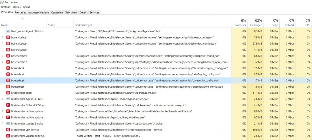

Hi everyone,
On one of my windows 10 laptops I had only 12 bitdefender processes running, I then rebooted and now I have 13 processes running while there are supposed to be 14 bitdefender processes.
One of the "bduserhost.exe" processes is missing (only 3 are running), on my other windows PC's I have the normal 14 processes running which 4 of them are the "bduserhost.exe".
The bitdefender total security does seem to run normal on this device with the missing process, everything is turned on and bitdefender shows green.
Is this normal or is this an issue?

  • camarie
    camarie Principal Software Developer BD Staff
    bduserhost.exe instances are launched depending on the settings/options/product installed. For example, if vulnerability monitoring is not enabled, the bduserhost instance with command line
    "C:\Program Files\Bitdefender\Bitdefender Security\bduserhost.exe" "settings/userprocesses/configs/bdwfagplg_config.json"
    is not launched (the wf from the argument means wifi).
    Other instances refers to Video & Audio Protection (…coreaudio.json), OneClick optimizer (..oneclickagent_config.json) etc.
    I'm not 1000% sure, but if no audio device is detected or the audio protection is not enabled, for example, the bduserhost.exe instance for audio protection is stopped as well.
    Overall, if no crashes or unwanted behavior arises, it is normal to have different number of running bduserhost instances on different systems if the options differ. Of course, this does not exclude a possible bug, but, to determine that, we need to know the command line of running instances on both machines to check what instance is not running, and from there to check also what settings are different, if any.

  • camarie
    Can you look in task manager, add the Command Line column, and specify the command lines of the running bduserhost.exe running? The important part is the ending, as in
    That's the information that tells what type of instances are running (and what it does not).
  • Petersl
    Petersl Defender of the month ✭✭✭✭
    Hi @camarie
    The "settings/userprocesses/configs/bdwfagplg_config.json" is running in one of the "bduserhost".
    I checked with my other PC that has 4 instances of the "bduserhost.exe" running and this one has "settings/userprocesses/configs/coreaudio_config.json" running as the 4th one that's the missing process on the other PC that only has the 3 "bduserhost.exe" running.
  • camarie
    So it's the coreaudio_config not running. Can you detail a little about the settings from Privacy, specifically Video & Audio Protection, as well as if there are audio/video devices active on that machine?
