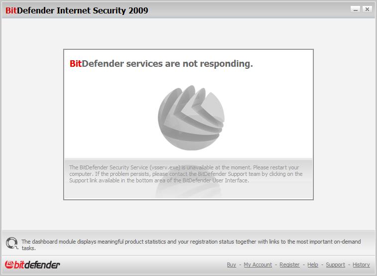

Bitdefender Services Are Not Responding
My BitDefender services are not responding. It says "The BitDefender security service (vsserv.exe) is unavailable at the moment. Please restart your computer. I've had to do this for like a week straight now everyday, its getting really annoying. Please HELP!!!. I'm running windows vista home professional 32-bit and BitDefender antivirus 2009

  • First, please check in the Task Manager if the process called "vsserv.exe" is running in the background and check how many threads does it have.
    Also, please tell me what other security solutions are you running on the system together with BitDefender.

    i have the same problem there is no vsserv.exe running and no other security maybe norton is the way forward???? ha ha

    I dont see any process running by that name. and BitDefender the only antivirus on my computer.

    My vsserv.exe is indeed still running in task manager despite the grey icon and the "Services not responding message". It has 55 threads.
    In answer to your other question Diana I am running threatfire alongside Bitdefender - no problems with it for a few days before the error. I uninstalled and reinstalled and got the same problem again.
    If it helps any both times my BD went grey and stopped responding I had put it into game mode. Probably coincidence, but you never know.

  • I'm having the same problem.... When I first start Vista, I'm able to click the destop icon for Total Security and I get the screen... but soon I get the VSSERV message. Seeing as it's the 3 PC version I bought, and installed them on all 3 of my PC's I checked the other 2 and no problem what so ever there.
    If I check the services by running SERVICES.MSC through the run box I notice that it says the service is indeed started, but I cannot stop it. I have no idea how to check how many threads it has...
    I'm not running any other software, and having heard that some malicious software can stop your defences from working this is kinda scaring my to no end.
    Is there any ETA as to a fix or update to help this ?
    PS : I have noticed that my PC (quad 6600) has been running rather slow lately.

  • I've had this problem recently and it has manifested as a freezing pc lately.....numerous times. Very disgusted with BD....
  • This issue started happening with a recent built update for BitDefender. In order to see what update files did not install correctly we will need to have a look at some reports generated on the systems where this issue is occurring. Thus I have created a support ticket for everybody who reported encountering this issue and they will receive an e-mail shortly.
    Diana,
    I will try to get this info but I'm not really sure if it will show up in this dump since I have to reset the pc to get it to work again.

    hemmath,
    after uninstalling and reinstalling the bitdefender, i now can use my bitdefender with my account
    thx
    but do u know what happen to my bitdefender? if such case happen again, what should i really do next time...

  • had the problem 5 months ago stopped working icons grey
    used removal tool from bd website
    then reinstalled with new download
    worked !
  • use uninstall tool
    then reinstall with new download

    as it seems i have the same pro since today morning, a grey icon and the message that vsserv.exe ist available at he moment ..... :(, i uninstalled it with the tool and reinstalled it, and problem still occurs ....
  • edited April 2009
    Hi YouChrisYap
    the problems with BD like in this thread happen (services won't respond) , if some files go missing!
    Files go missing if the system restore is not properly done, if you have used a registry cleaner or by some other way!
    The best way to bring BD back to work is by reinstalling!

    could you run sfc/scannow and see if the system files are fine?

  • I get this problem all the time if I get a Windows Update in WinXP to any of the .NET frameworks. I think this problem occurs more often than not if you have .NET 3.5 framework installed.

    im disappointed to say that my bd now is not running again(same prob) after i updated it...
    i have a Registry Mechanic in my laptop, does it affect bd?
  • edited April 2009
    Hi YouChrisYap
    Yes, Registry Mechanic deleted some keys of BD from your registry. I had Registry Mechanic, but don't use it any more! You could report this problem to Registry Mechanic.
    If you are looking for a good registry error correction software, try Tune-up Utilities. This does not have any problems with BD.
    Hemanth

    The error message "Services not responding" can have multiple causes, in order to make sure that we correctly identify the reason why this message comes up we need to treat each report individually.
    chunks, hadyhosny, mgu, frosti, tütücaca, cosmic_nomad
    I have created support tickets for all of you in our database and sent you some diagnostic tools for the system. Please reply to the e-mails that you have received attaching the reports
    In case anybody else encounters this error message with BitDefender I would recommend contacting support and attaching the reports generated by the diagnostic tools available in the following article - you have a link in the bottom part of the article on how to contact support:
    http://www.bitdefender.com/site/KnowledgeBase/consumer/#389

    problems with BD could happen if you have run a patch to extend the trial period of BD!
    Could you install it again? Just remove it from BD's own uninstall tool available at http://www.bitdefender.com/uninstall, and then you could install.
    Hemanth
    Problem Solved in my case!!
    I use a registry cleaner (CCleaner) and always back up my registry before running it. It had removed Bitdefender entries that were needed. Once I restored the registry my Bitdefender worked fine.
  • @adkr
    I am using CCleaner myself. Would it be affecting my PC as well? I'll reinstall Bitdefender IS 2009 (I uninstall it) and see how it goes. Thanks for letting us know.
