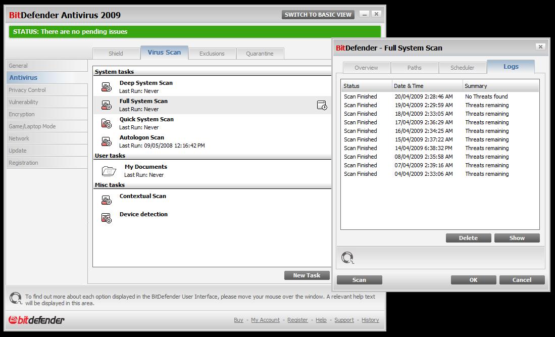

I applied the steps in KB#547 to successfully fix "scan failed to execute" errors, but now I get incorrect Last Run dates. Logs are correct. How do I fix this?0 -

Nope. That didn't work. I disabled UAC and ran a Quick System Scan.
After it completed, it still shows a March 13th date (which is the date of the FIRST Quick System Scan).
Is there not a patch for this?0 -
Hello stimbo,
The quick system scan will not count as a system scan - in order to run a system scan please try running a full or a deep system scan and tell us if the notification in the dashboard has changed.0
