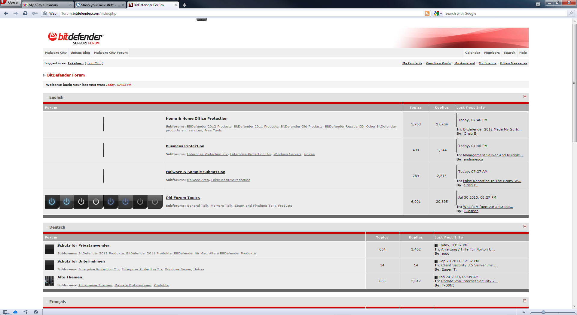

After re-installing IS 2012 I found that I was having image corruptions. This boiled down to the toolbar being at fault. It didn't matter if I used Internet Explorer or Opera, a few images got corrupted. Uninstall time.
Now, at this point, the installing and uninstalling attempts got a bit hazy. However, I can tell you that I was having one of the two issues described above. I believe the third time that I installed I was presented with the original problem with playing YouTube videos and the fourth time went back to the corrupted images. I have, on numerous occasions, attempted to remove the toolbar to correct this issue. This involved (in no particular order) pressing the power button on the toolbar itself, deselecting the three options on the toolbar, opening the main console and disabling all of the options in the privacy section, disabling scanning of HTTP traffic and disabling Data Protection. Now, being security software, I'm not best comfortable with disabling any of the options other than the web browser toolbar(s). However, this is what has been recommended by staff via the web chat and/or e-mail.
I did also uninstall IS 2012 for about a month at one point (I installed in July, originally) and made do without it. What I used in its place is irrelevant. When I re-installed I have been having the problem of corrupted images ever since. For an example of corrupted images, please see the screenshot here.
