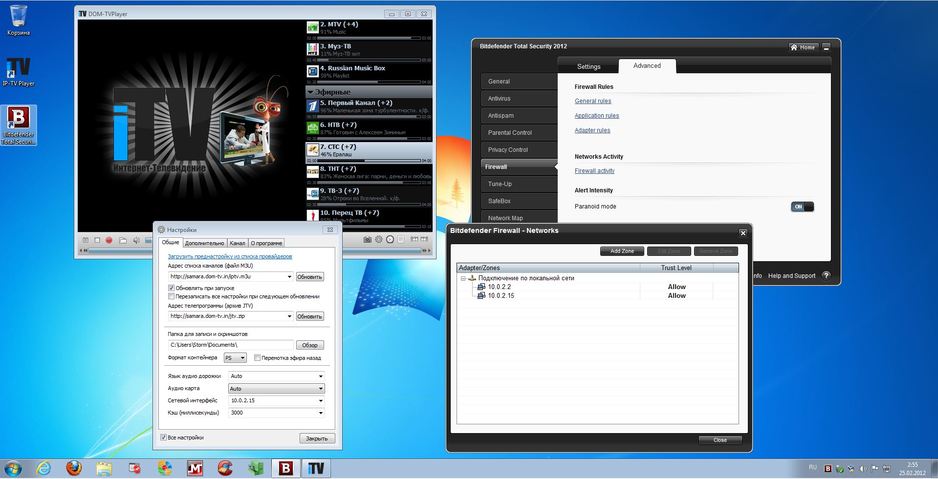

I would like to announce such a problem, the fact that the Bitdefender 2012 somehow my drivers or anything blocking me IPtv player, when the system is clean without any bits of all the works as soon as the bit, there is a lock, played with the settings all the checkboxes mark, tested and on a laptop and a home stationary PCs, all of the Windows 7 x64 SP1!
What nonsense I'll never know, can not do so, and brought to the exceptions as have not tried it, if the bit is set in the system, all the player does not plow, how to remove bits of reboot everything will work wonders then what I know it will assume that the driver faervola bitdefendera somewhere that is blocking, but that's how it is solved, and how, because I would like to use the product even though the laptop to stay, but IPtv I need since I only watch it and I have no telly!
Screenshots of the virtual system, Windows 7 x64 SP1 just does not work, checked builds and Russian and British past, developers have to pass, it can be a serious bug, if I'm certainly not the case where the fact that it has made to exclude or to set up then please help!

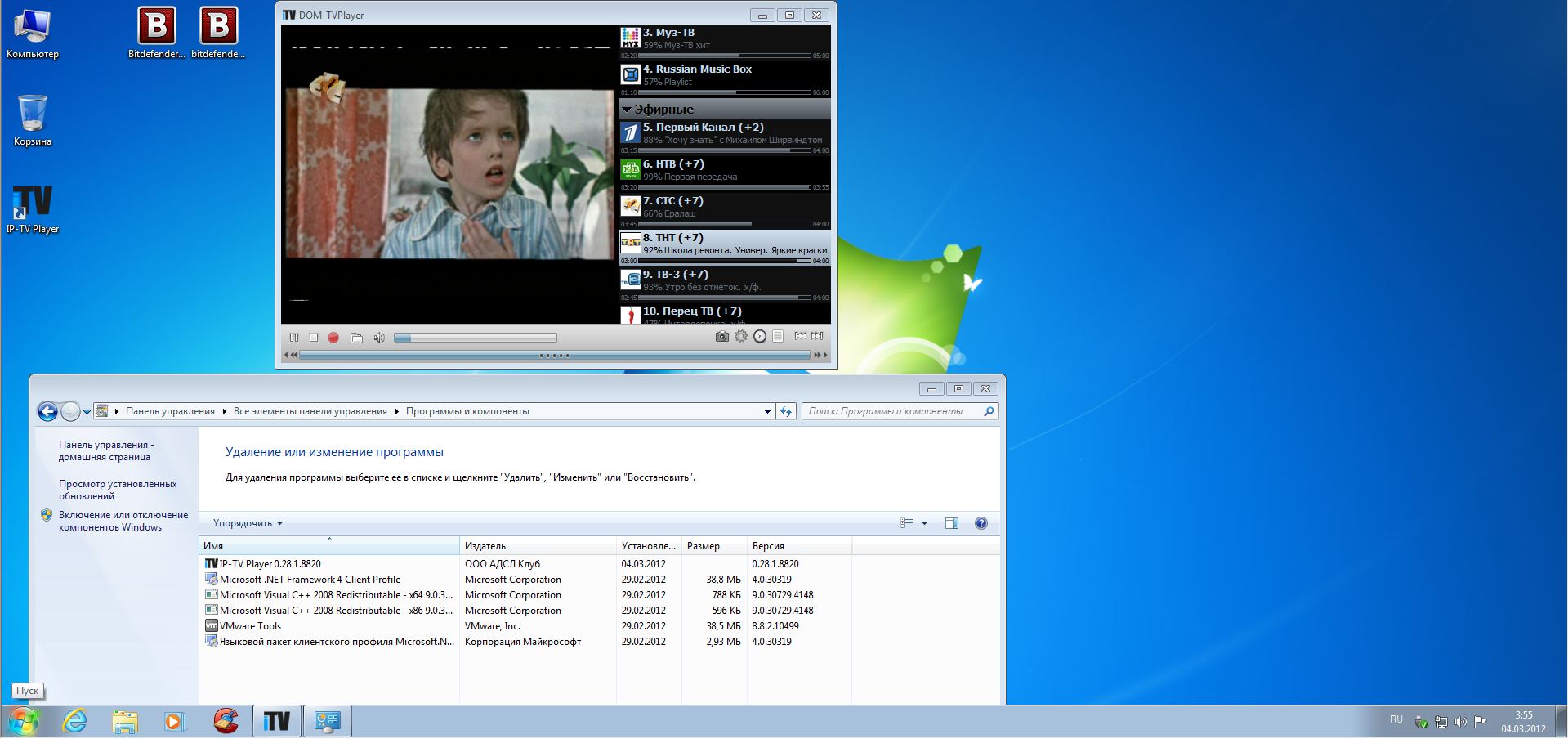

In a real system also does not work so I had yet to remove from the bitdefender windose to be somtret iptv
Therefore, showing you on VMWare
No, I tried the latest version of the english in it cover those issues is not working player, I just noticed you right out of Russia and I would like to fix the problem was in the Russian version I am not alone with this problem for all who have the same pleeer IPTv same problem!0 -
