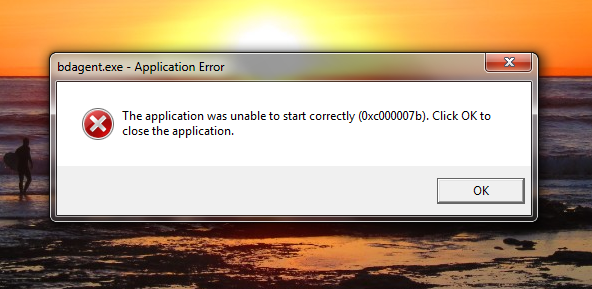

After hours of frustration...Bitdefender Total Security 2013 wont install on my computer. I keep getting error 0xc000007b. I have uninstalled, used bitdefender's uninstall, and reinstalled many many times. I have removed my previous security program (Norton's).
My system uses Windows 7 64 bit. If anyone can help, much appreciated. Otherwise, I demand a refund.

I've done everything described in the above link I'm still getting the same error message. I uninstalled all anti-virus/internet security programs. I used CCleaner and ran it as was directed, I downloaded and ran Argente as directed, and I downloaded the offline setup and installed as directed. Still the SAME error message occurs. Please help.

This error message may occur on 64 bit operating systems when the Microsoft Visual C++ Redistributable Package is not properly configured.
