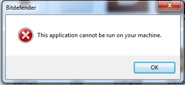

I tried running the installation from normal and safemode. both without success.
Tried removing Kaspersky (my previous anti virus), tried with the bitdefender uninstaller. Run both in safemode all without success either.
I am running on Windows 7 sp1, meeting all the system requirements.

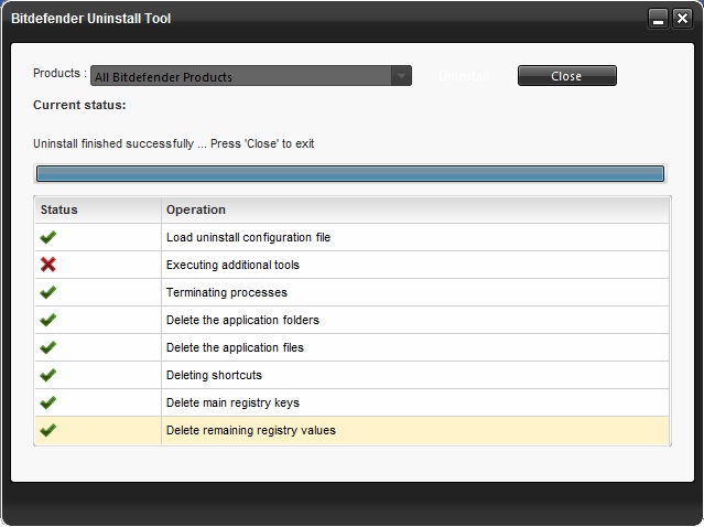

By the way, when I was uninstalling Bitdefender, there is a red X on one of the item, not sure if this is the cause.

Hello MyNEO,
When running the Bitdefender uninstall tool is normal to have some entries marked as X. The tool is searching for all the Bitdefender products associated with that suite and there is no way to have them all installed.
Now, regarding the installation error "The application can not be run on your machine", could you please tell me if you are trying to install from the Bitdefender DVD? If you are, please try to use the full installation kit, from here:
http://forum.bitdefender.com/index.php?showtopic=35494
Let me know how is everything going.0 -
