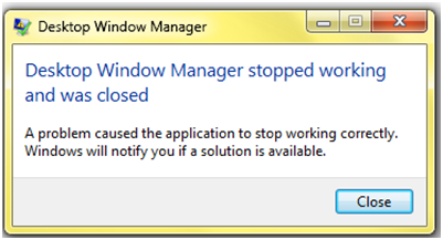

One of our machines (HP Pavilion dv7 Notebook PC running Windows Vista x64) will receive the error "Desktop Window Manager stopped working and was closed" with the open to close the error. It will reappear within a few minutes, happening about 5 times per hour.

  • The error itself is a on-screen window that appears after the screen flashes back to a non-aero theme, then back to aero. The error looks like this Screen%20shot%2001.png
