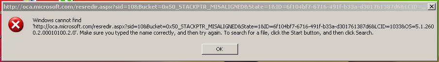

Well we're winning nothing was found using Malwarebytes and now when rebooting at startup I get the windows error noise and a box appears saying windows can't find the file called ali.exe and so on.

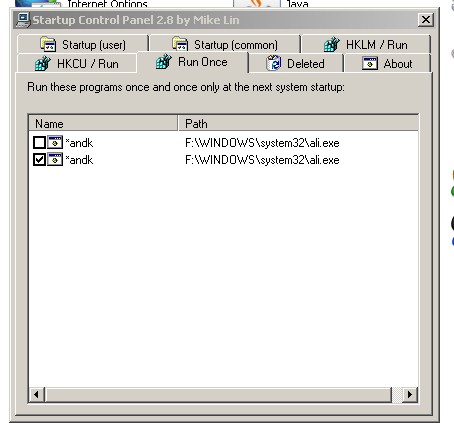

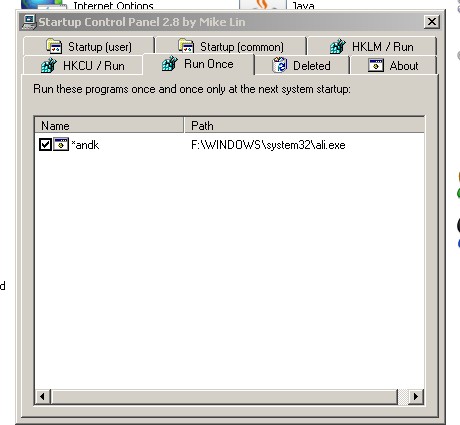

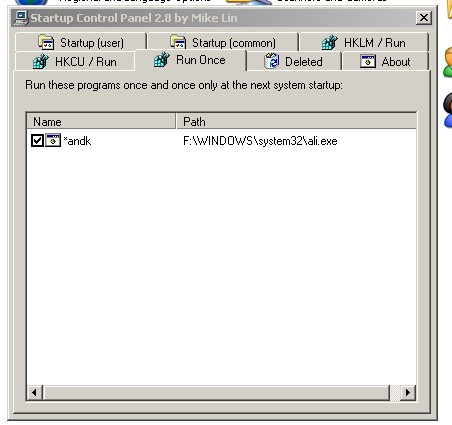

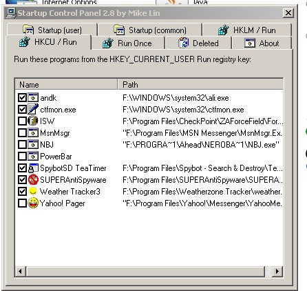

Some of the bug is left behind here, I've added a couple of screen shots to show you
Deactivate ali.exe from statup !
Ali.exe is a trojan !
It was deleted !
Uncheck that from startup
Deactivate ali.exe from statup !Ali.exe is a trojan ! It was deleted ! Uncheck that from startup
Hey again crysty2k5, If I uncheck it from start up it replaces it self straight away..

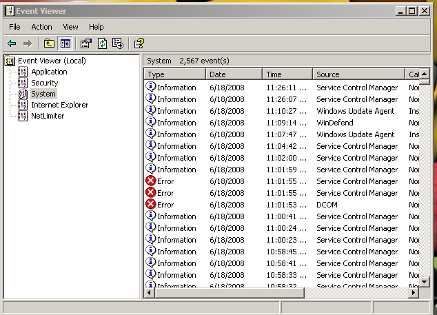

Hey guys just had this "The system has recovered from a serious error." it shut down while using the PC and that was on the screen after it re-started itself..
Also this 20-30sec after

For concerning the windows error can you please do this. Press the windows button together with r now type eventvwr press enter. Now open the application and system logbooks and post the error entries here that occured when you had that error message.
Hello mag,Sorry a bit late but still a Happy Birthday. For concerning the windows error can you please do this. Press the windows button together with r now type eventvwr press enter. Now open the application and system logbooks and post the error entries here that occured when you had that error message. Best regards, Niels
A bit late for B/day is not a problem.. Thanks Niels
Ok will post the error entries..
A bit late for B/day is not a problem.. Thanks Niels Ok will post the error entries..
Todays errors...
/applications/core/interface/file/attachment.php?id=2259" data-fileid="2259" rel="">report1.txt
Can you please do the following once you are in the evenviewer doubleclick on the error entries. Please press on the icon that looks like 2 piece of paper now press on paste once you are in notepad. I know that it's my fault but I needed a description of the errormessage. Sorry for that. Can you please do that and attach it also in a new txt file. When does it normally happens that windows error noise? What are you doing at that particular moment?
Hello mag,Can you please do the following once you are in the evenviewer doubleclick on the error entries. Please press on the icon that looks like 2 piece of paper now press on paste once you are in notepad. I know that it's my fault but I needed a description of the errormessage. Sorry for that. Can you please do that and attach it also in a new txt file. When does it normally happens that windows error noise? What are you doing at that particular moment? Best regards, Niels
Hi Niels, sorry but I'm still not sure what you mean "looks like 2 piece of paper" so is this correct
/applications/core/interface/file/attachment.php?id=2264" data-fileid="2264" rel="">report.txt
My problem is that I don't know how it's called in English. No, you first need to double click on an entry. First you need to left click on an entry that has an error sign a red circle with a white cross inside. So it will high light in blue. After that double click on it. If you have done that then you should see an icon that looks like 2 papers.
Hello mag,My problem is that I don't know how it's called in English. No, you first need to double click on an entry. First you need to left click on an entry that has an error sign a red circle with a white cross inside. So it will high light in blue. After that double click on it. If you have done that then you should see an icon that looks like 2 papers. Best regards, Niels
2 pages ?? But I don't speak English I speak "Australian" " />
Now I think I've got it and went back as far as the error that shut down the P.C..
/applications/core/interface/file/attachment.php?id=2274" data-fileid="2274" rel="">new.txt
Thanks for the information. From what I looked the problem might be caused by Zonealarm and Norton update service. So if understand it correctly your pc automatically reboot or shutdown itself? If that is the case can you please do the following : click on start,right click on my computer choose properties,advanced,press on the settings button that is located under the startup and repair (recover) settings (it could have a different name because I don't know how it's called in Australian (English). Under Write Debugging Information select minidump. Once it again appears can you please do this click on start,my computer,windows,Minidump,attach the dmp file (that are all the files that are stored in that folder). Be sure to not send any error reports to Microsoft before copying the dmp file otherwise the minidump folder will be empty.
