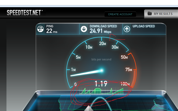

    Ok, I'm not sure that it's "fixed".. After undoing the fix that Christian suggested I ran through a series of tests and this is what I get..
    Speed test- one out of every 3 tests that I run is "smooth" without the jaggies... This is not right.. - I run this very same test from my router and it always comes back smooth... I run this very same test from another computer without a BD product installed and it runs smooth..

  • okay so I uploaded the screen shoot of yesterdays result and how it is working today. I did send an e-mail right now saying my connection is still not at an optimal level.
    This was my connection before
    Yesterday
    Today

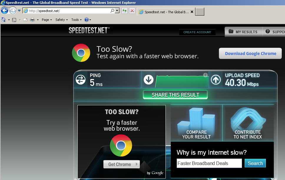

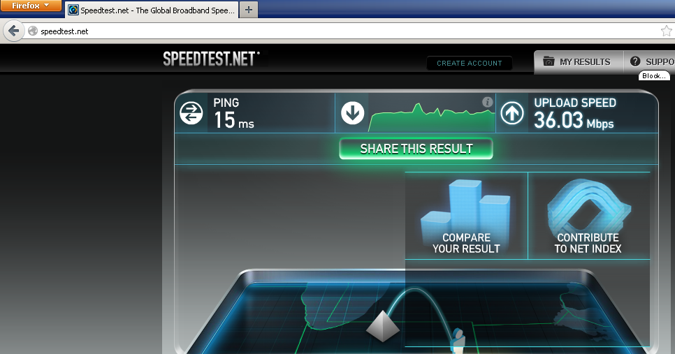

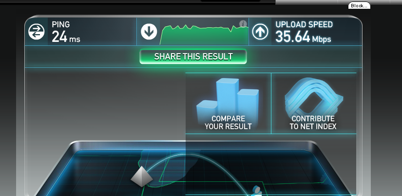

  • I haven't received a reply but I noticed my IE connection is almost perfect compared to my FireFox connection
    FireFox
    Internet Explorer
    I'd like as much feedback so I can help speed up this fix. If people would post results from both browsers I'd appreciate it.
    I still am not updating the engine and am only updating the virus files, but I ran IE and Firefox speedtests and IE was a little better than Firefox, but both were pretty bad this time.
