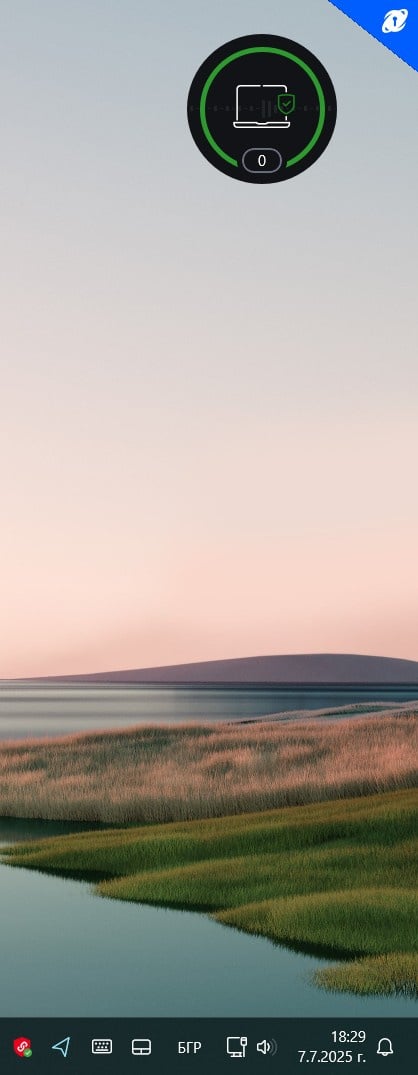

This is how the screen looks when Safepay is minimized. When turned on, the VPN icon is again inactive.
So VPN is connected. What does it means "When turned on" ?

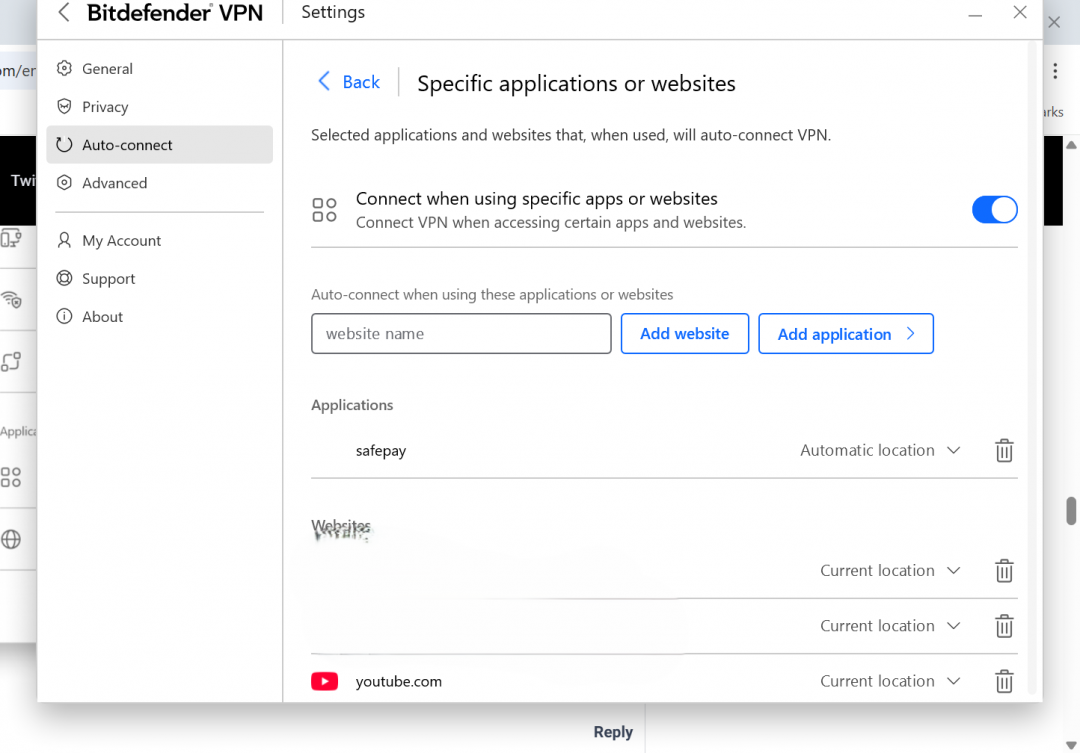

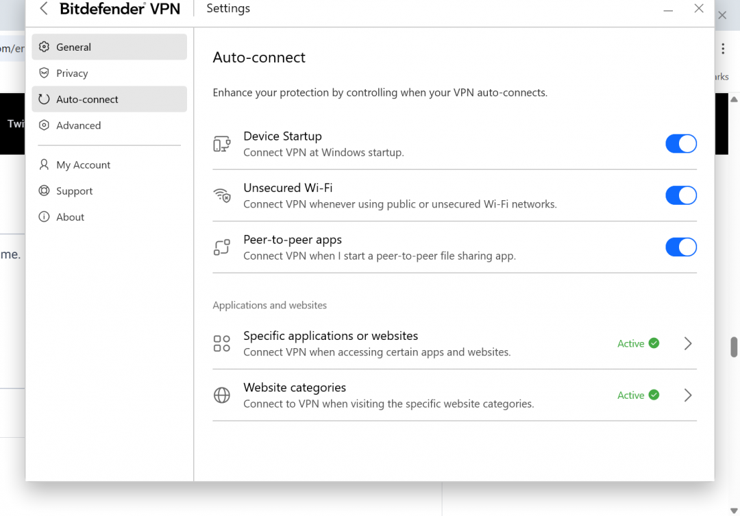

Same issue with Safepay for me. VPN setting is "Open automatically when Safepay opens". "Safepay" is listed as application for Specific Applications and website. Regarding "safepay" as specific application listed, I just typed it in and selected Apps.
