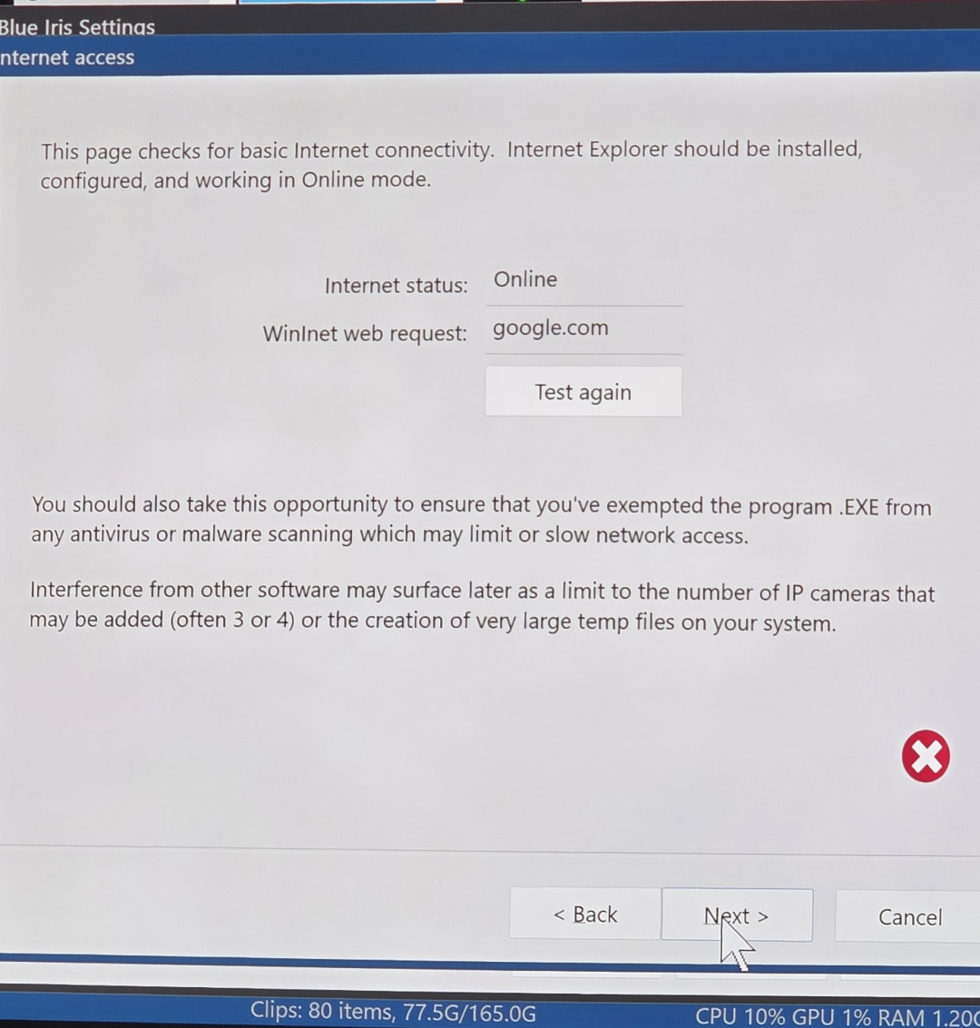

I have been using Blue Iris Software for several of my local ip cams. Yet, after installing Bitdefender I am unable to view my cameras remotely. Any step-by-step advice on how to configure is greatly appreciated…
Internet Status:

Hello,
One more thing to add here, in the Firewall tab, click on Settings, then for the network you're currently connected to, uncheck the 'Stealth Mode' button to disable it. This setting establishes whether your device can be visible to other devices on the same network, for example other computers, printers, cameras, etc. If 'Stealth Mode' is enabled, most likely the cameras will no longer communicate with your device, therefore you can no longer see them.
