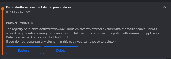

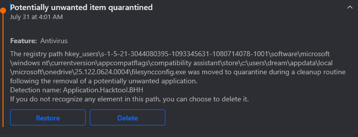

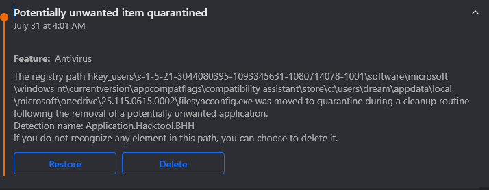

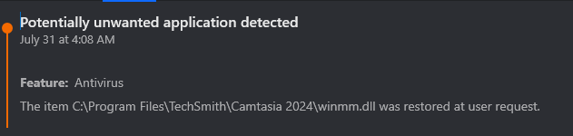

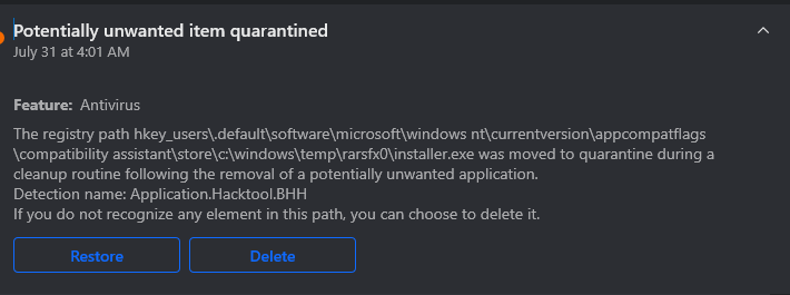

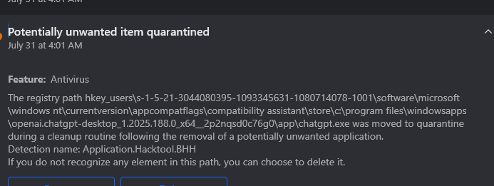

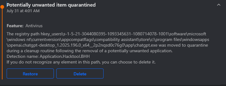

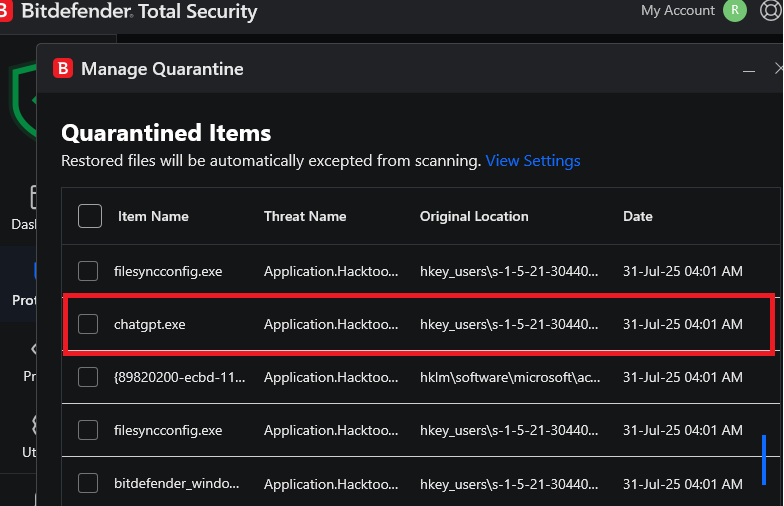

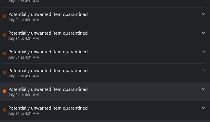

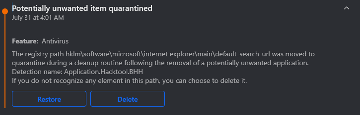

Thx v much for your detailed look on the matter , i ran full system scan + custom scan ( scanned all files ) and rescue scan as well , nothing was found ( locked files were not scanned ) , should i scan the suspicious usb or perform full system scan after inserting it in the pc? anyhow i found some suspicious files later but those could be a pert of recently installed software and i m suspecting that the back ground opening of the unknown websites ( discussed with you b4 ) could be a part of such suspicious files hunted by bitdefender now. ve a look.
much more
started after that:
i just restored the last one and did not allowed all of the others. i inserted all of my usbs in the pc, even win 10 installation media too, i do not ve another pc, what should i do know if i perform a clean install? what is this hack tool and why is it related with chat gpt and all other legitimate softwares.
