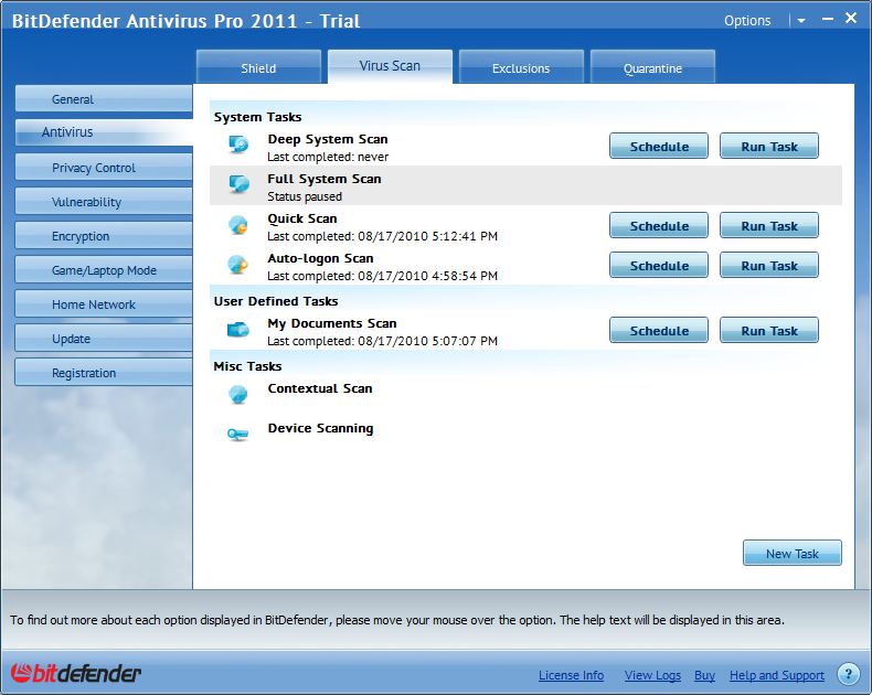

Since then, however, The Full System Scan has run on its own, over and over several times. Here is the screenshot of the log showing all the scans:
I tried to go into the Full System Scan, scan settings, but with the scan paused, I can't get into the options to see how it is set and if it is wrong, change it. Here is that screenshot:
How do I stop the scans?

Hi Gary,
I do believe that those scans were run due to an option being checked under BitDefender menu that comes as enabled by default for Total Security 2011. Follow the steps below and let me know if the issue is resolved:
- open BitDefender Security Center and switch it to Expert View from the Options button
- go to the Tune-up module
- click on 'Optimization' tab
- uncheck the box under Product Actions When Idle so the Full system scan will not start when your system is idle.
Regards,0 -
Oh, you are good!
That's exactly what it was. Actually, it was happening on the desktop system as well, but since I was using that PC most of the day yesterday, the scan had only started once and I didn't even realize it had happened until I looked at the log.
I've unchecked that box on both PCs. I don't need that much unwanted hard disk drive activity.
