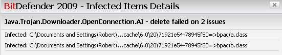

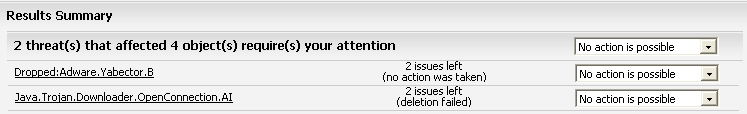

Getting a "disinfection failed" message with Java.Trojan.Downloader.OpenConnection.AI Why can't BD remove this and how do I remove it?
Below are two screen shots. Thanks

This type of infection can be removed by clearing the Java cache from Control Panel -> Java -> Settings -> Delete files.
Also make sure that your Java is up to date.
