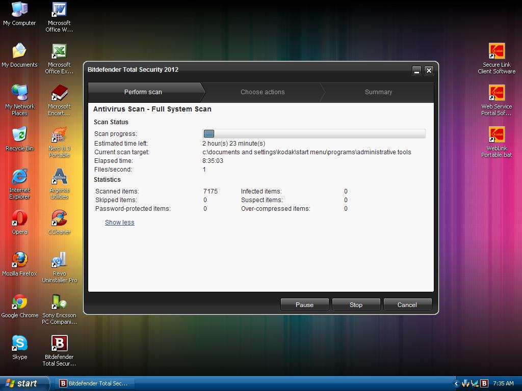

    I re-install my Bitdefender, and ran Full System Scan and after a scan of more than 8 and half hours, it scans only 7175 items................amazing :rolleyes: ..............I have to stop the scan then. -_-
    Scan Log and screen shot are attached.
    /applications/core/interface/file/attachment.php?id=8157" data-fileid="8157" rel="">1313517645_3_01.xml
