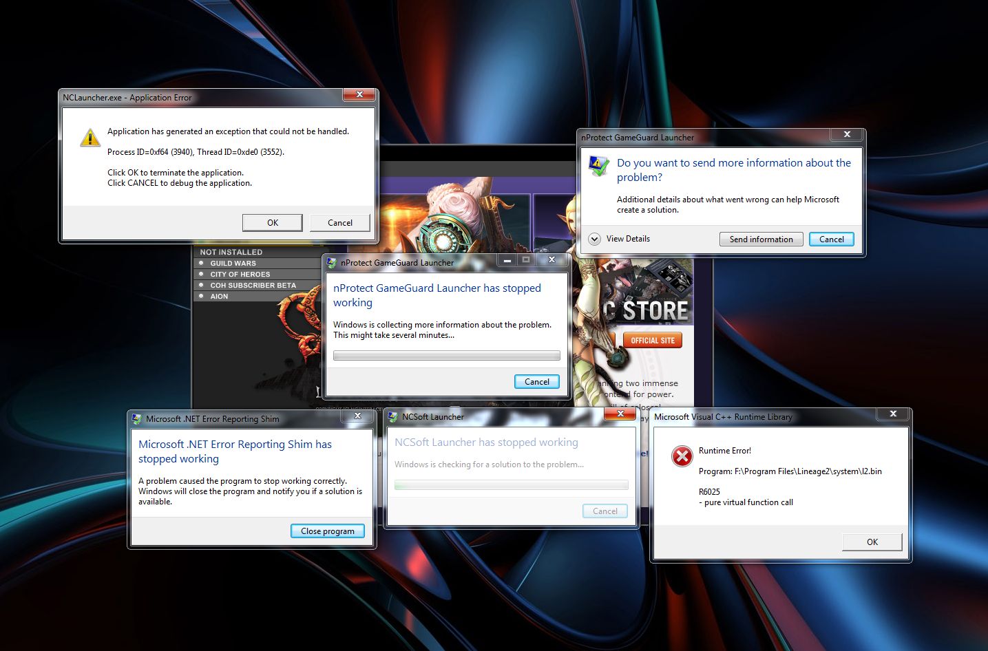

Oh boy
Did all that - switched to BD2012TS(en) + updated - and i got to the problem lincsz2001 had - complete crash of the game -
" Runtime Error!
Program: l2.bin
R6025
-pure virtual function call "
The whole directory was on exclusion from virus check
Rules in place for all the above mentioned - gamemon.des + gameguard.des + l2.bin + NCLauncher.exe
It seemed that the game was corrupted but i gave it a go and uninstalled the whole BD suite.
I am now in the actual game.
I am not that passionate about this game in particular but NCsoft is the publisher for a few other games and some of them are due to come out and i am guessing that they will keep on using gameguard as cheat-control rendering the issue, of sorting things out, a must.
Any ideas Cristi B. ?0 -

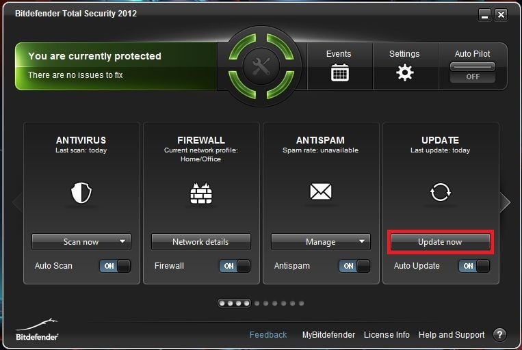

After these installation of Bitdefender 2012, did you run a manual update from the main interface?
I am telling you this because the update for Active Virus Control is installed via Update and not during the installation of the product.
Thank you.0 -
Thank you.
Yes i did it from here :0 -

Hi guys
Thank you for your feedback.
Since the initial feedback is positive, I will provide you complete instructions regarding this issue. This is just a temporary workaround until the Active Virus Control module is updated to fix this issue.
1. Restart your computer in Safe Mode:
[How to restart in Safe Mode]
- Restart the computer (Windows Start button - Turn Off - Restart);
- Press the "F8" key several times before Microsoft Windows begins to load;
you need to press "F8" until you will be displayed a text menu;
- Select "SAFE MODE" in the text menu and press "Enter".
- Wait while Windows loads in Safe Mode; this process ends with a confirmation
message; click "OK" to acknowledge.
2. Locate the file "avc3.sys"and rename it into "avc3.sy_";
[how to disable Bitdefender product updates]:
1. Locate the file:
C:\Program Files\BitDefender\BitDefender 2012\update_components.xml
2. Open the file with Notepad and modify the following line:
<Product enabled="1" name="00010004000500010001000600050001" type="0" id="-1">
Basically you will modify the "1" into "0" (only the first "1" from the line).
3. Save the file (overwrite the original XML file);
4. Restart the PC in normal mode.
As soon as we release the update, you will have to undo all these steps in order for the software to receive again product updates.
The update will be announced here:
http://forum.bitdefender.com/index.php?showtopic=28172
Now, you can set the updates to Silent and you won't receive a pop-up to update Bitdefender each hour.
Open BitDefender -> Settings -> Update -> here check the box next to Silent update.
Please let us know if the above steps resolved the issue or it still persists. Looking forward to your answer.
Thank you for your patience and for the cooperation with BitDefender team.0 -
