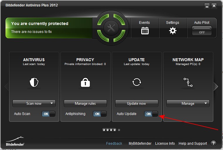

  • You can turn off auto update on the main BD screen:
    Regards,

  • Internet Security 2012's Limited Auto-update Options
    I found the answer myself. There's no option to turn auto-update off in the Update screen, but there is one in the main program control interface.
