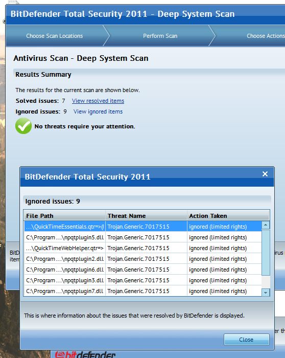

I was doing a full system scan as well as a deep system scan. When it was done it said I had 6 Trojan viruses but said they were ignored due to limited administrative rights?
I also have the same problem - please see the attached.
It started yesterday and i did a deep scan and bitdefender ignored these trojans. If someone could help me with this - I'd appreciate it.

I have updated my virus definitions and did another deep scan. I have attached the latest deep scan results.
I did the quick scan also - and it found the same infected files. I am fine with sending you the file directly but since it has all my port and ip addresses, i don't think it is safe to attach in an open forum where anyone can access it. Is it?
Found 7 infected files!
C:\Program Files (x86)\Internet Explorer\plugins\npqtplugin7.dll --> Trojan.Generic.7017515
C:\Program Files (x86)\Internet Explorer\plugins\npqtplugin3.dll --> Trojan.Generic.7017515
C:\Program Files (x86)\Internet Explorer\plugins\npqtplugin.dll --> Trojan.Generic.7017515
C:\Program Files (x86)\Internet Explorer\plugins\npqtplugin6.dll --> Trojan.Generic.7017515
C:\Program Files (x86)\Internet Explorer\plugins\npqtplugin4.dll --> Trojan.Generic.7017515
C:\Program Files (x86)\Internet Explorer\plugins\npqtplugin2.dll --> Trojan.Generic.7017515
C:\Program Files (x86)\Internet Explorer\plugins\npqtplugin5.dll --> Trojan.Generic.7017515

Welcome back and thank you for the details.
Trojan.Generic.7017515 is a False Positive(Apple QuickTime Plugin from Internet Explorer/Firefox is CLEAN). Detection has been removed and the update was released in the market. Servers are synchronizing(right now) and in about one hour those files won't be detected.
Until then, please ignore those detections, reboot your machine and manually update Bitdefender.
After that rerun a Deep Scan.
We are sorry for the inconvenience.
If you still need assistance, I am here for you
Take care.
