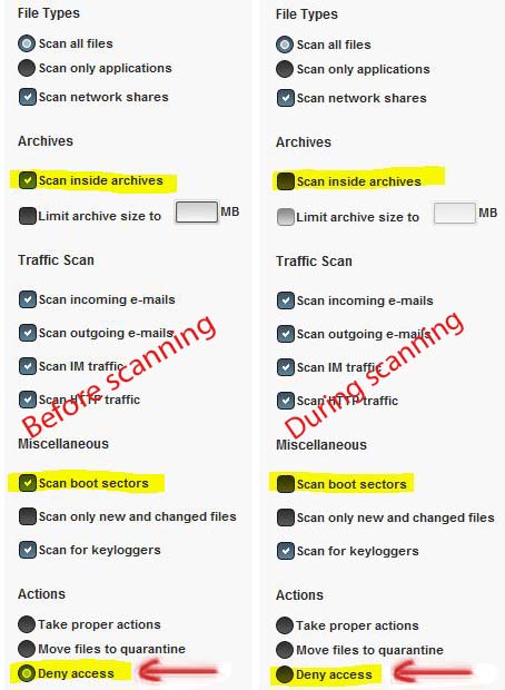

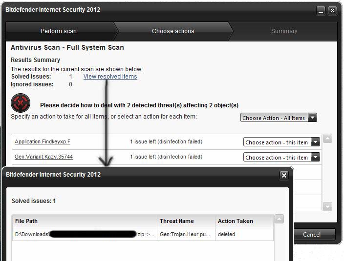

I decided to make a "Full System Scan" today with BDIS 2012(15.0.37.1568) on Win7 Ultimate SP1. When it's finished, reported that there were 5 infected files. Three of them were deleted without prompt me or let me choose for an action as for the other two files did (because it could not delete them).
Please tell me, is there any way to avoid this mess or when BDIS performs a "Full System Scan" we have to "cry" for our lost files?
Anyway, users MUST decide what to do with the "infected" files.
P S : In antivirus shield "Deny access" was checked.

The following files were resolved delete during the scanning process.\Temp\stelios\XXXX=>file.exe threatName=Backdoor.Generic.510319
\Downloads\XXXX.zip=>file.exe threatName=Gen:Trojan.Heur.puW@Iy9S99di

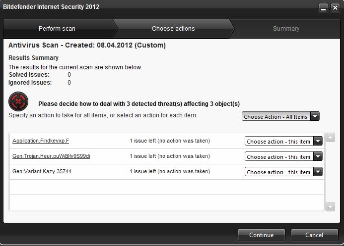

When a full system scan or a custom scan is finished, the user can take actions for the files, but there is a default action checked, maybe you skipped or you didn't change that value.

Hi Christian,
I know that. But, when the scanning finished, reported that there was 5 infected files, three of them deleted and for the other two it asked me for an action. So how can be explained this? And Please believe me that I did not skip any option. Remember, this is an issue that exists from the first day of BDIS2012 release.

Hello
After many discussions I can now provide you an official answer:
The behavior is normal: the Full Scan has default actions set, opposed to custom scan (you can see that the Full scan tried to take actions on the other 2 files as well, only that the action failed).
If you want to prevent automatic actions in the future, you need to create a Custom Scan and customize all the options from there to fit your needs.

Hello Christian,
Ok. I got it. Anyway, I run only Custom Scan when I need it.
But believe me, this is not a normal behavior. Maybe it's a mistake that now it's difficult to be corrected.
Full and Custom Scan MUST have the same behavior or else user is confused and the result is lost files. Even you didn't know it and I think this is a proof for this abnormal behavior. I really cannot understand the reason of this difference.
So, if I want to run a Full System Scan but with no lost files, I have to run a Custom Scan checking all drives, options etc. Is it simple??? Is it logical???
