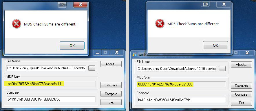

Hi mrpolimero
Here's what I tried:
• Last night I uninstalled BD and downloaded the Ubuntu file 2 times in FF v.17 on an Ethernet connected PC (TP-Link router WRN1043ND) with Charter cables 30 Mb service, on a Windows 7 64-bit PC, with no corruptions.
• I then installed BD AV+, with Window Firewall enabled on the same PC above and downloaded it 2 times, using FF, and checked the files, with no corruptions.
• This morning I rechecked the file from last night, and was given 2 different MD5 Sums errors from the software itself? (see image below)
• I re-downloaded Ubuntu about 5-7 times this morning on the same desktop PC, and I had 2 corrupt versions, I believe one was in Chrome
(v. 24.0.xxx), and the other in FF.
This morning I thought I'd try my notebook running Window 7 64-bit with BD IS 2013, using my TP-Link wireless N set up (i.e. good speeds, no lags) had no corruptions at all using FF and Chrome. I probably tried about 6-8 times, no problems.
I then went to my Windows 8 Pro 64-bit partition of that notebook, running the BD W8 version, again with both FF and Chrome, no corruptions. I probably downloaded it and check it about 4-5 times.
Most of the times I tried to clear the history, cookies etc. or running CCleaner before downloading. This didn't seem to help or hurt as far as corruptions, as with the ones I forgot to do a clean up before downloading, they were not corrupted. I also deleted all downloaded files of Ububtu from the recycle bin before I started a new download (i.e. no 2nd, 3rd versions in My Downloads)
So, with the approx 25 times I downloaded and checked Ubuntu, I had 2 corruptions, and a "false positive" within the winMD5sum software itself. In the case of Ubuntu downloads, could it be more of an issue of the mirrors, and which one you end up getting your download from ( was from at least 3 different servers, i.e. schools) that is corrupting it?0 -
Hi mrpolimero
