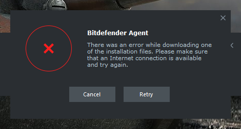

I have problems installing my bitdefender antivirus in windows 10 version 1607, it fails when I try to download the antivirus, I have followed all the guides to fix the problem, replacing files in bitdefender agent forum in safe mode, cleaned everything with the tool, disabled windows defender and windows firewall, unlocked the installer, and formatted my pc twice, this is getting really annoying I cant fix this mess....

    Hello,
    Please ensure you have installed the latest drivers for your Network Card and removed any other security solutions.
    Also please let me know what ping response are you getting when pinging : bd.bdnc.net

    I already have the latest drivers from killer network card.
    Going to try that ping but looks like there are more users who have problems reaching your servers.... I have fixed the issues but its not the best method I think. What I did to fix this:
    I tried to download the installed but it failed every time, so I used proxysite.com to download the offline installer
    After that I installed the client without problems but I had to fix this for myself, you should provide a full client for offline installer and avoid this mess.
    Maybe this can help more people in the future with the same issue. But I ask you nicely that look at this problem please. Cheers

    Dear Sorin, I have tested inmy main PC too (3 different connections) and the problem still persist, I live in Chile south America, but as soon as I use a proxy config I can download the files, looks like my country is black listed lol. But this didn't happen before...with the 2015 product if I recall correctly

    There are no blacklists on your ISP (current forum ip). This might actually be a ISP peering issue.
    If you use the Google DNS does the issue persist ?

  • Using the google DNS I can't even find the host...
  • Dear Sorin, I have tested inmy main PC too (3 different connections) and the problem still persist, I live in Chile south America, but as soon as I use a proxy config I can download the files, looks like my country is black listed lol. But this didn't happen before...with the 2015 product if I recall correctly
    myI have exactly the same problem as you. Do you think it's my proxy settings or a problem with my provider?
  • Dear friend according to my investigation looks like the fault here is from the ISP, that's why I had to use a site to download the offline installer using proxysite.com in order to proceed and get a success installation
