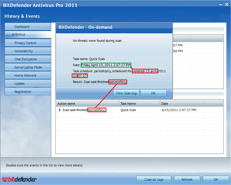

Here's the summary and screenshot from the last mail:
- View Logs|Antivirus|On-demand Tasks: Typo in "Scan task finished successfuly"
- View Logs|Antivirus|On-demand Tasks|Double-click on a task|Task schedule: Typo, missing space after "scheduled for:"
- View Logs|Antivirus|On-demand Tasks|Double-click on a task|Task schedule: Wrong date/time format. It is using French format and French day names when the previous line "Date" is in the correct English-US locale. The only thing French in my system is the default keyboard layout, my location is US, time zone Pacific GMT-8, user locale and display language English-US, and everything was set this way at the time of BDA installation and scan task scheduling.
- View Logs|Antivirus|On-demand Tasks|Double-click on a task|Task schedule: Wrong scheduled time. The log says the next scheduled scan is in 7 hours instead of 24 (scan scheduled daily), plus the start time for the next scan task is actually using the minutes and seconds of the end time of the past task. Possibly linked to the above format issue.
