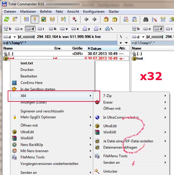

After installation of BD-IS on Win7-x64 integration to common spreaded file manager Total Commander (Ghisler) in x32 version fails.
In x64 version of TC right click context menu shows the Bitdefender entries (on demand scan, shredder) as expected, check tc.jpg.
In x32 version of TC right click context menu shows all other x64 extensions ecept the BD entries, check tc-x64.jpg.
Because of some most important x32-only plugins often the x32 version of TC is necessary!
In Total Commander's support forum this issue is well known, but NOT depending on TC but on Bitdefender's behaviour to handle the extensions.

  • There is an new hint from Ghisler (author of Total Commander) at the link shown above:
    The tcmdx64 tool loads all 64-bit shell extensions and asks them to return their context menu entries. That's how most externsions work. However, there seem to be some extensions which list menu items in the registry, so the Explorer can grab them from there. TC does not currently support this method because it's badly described, and I have never seen an extension which uses it. Maybe BitDefender uses this method.

    There are two things here.
    1. TC does *not* pass current directory (as explorer does) when invoking the context menu, so there is no direct way of knowing in which folder the command is invoked.
    File vault extension have *special* code to detect if caller process is TC, and have internal code to patch this and extract the correct directory.
    We'll examine if we can use the same trick also for scan extension.
    2. For X86, it is most likely that also the 32-bit shell extension should be registered on 64-bit system.
    We're check this out and we'll supply in a next update.

  • Additional from TC forum:
    2camarie:
    The x32 loads x64 extensions into special submenu "x64" using a hidden 64-bit program tcmdx64.exe.
