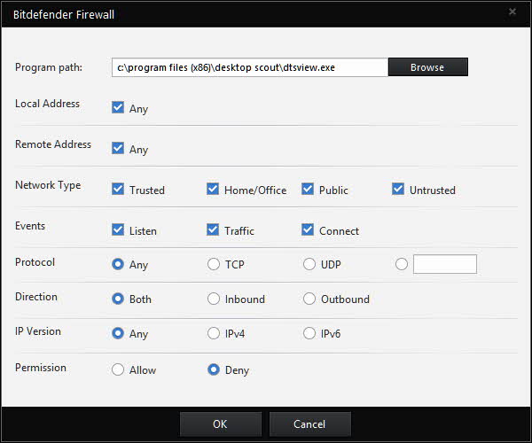

It's definitely dtsview.exe that is accessing the LAN even after Deny is set. I do have dtsview.exe set to be excluded from On-access and On-demand scans, but neither the interface nor the help file indicate that this also excludes it from being blocked, even if it is set to Deny.
If I block uTorrent.exe in the same way, it doesn't make connections to other clients, but it is still able to check for updates.
Am I just not understanding the unintuitive manner in which BD applies firewall access rules?0 -

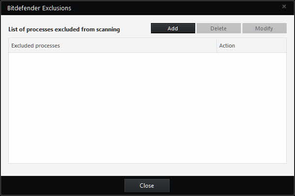

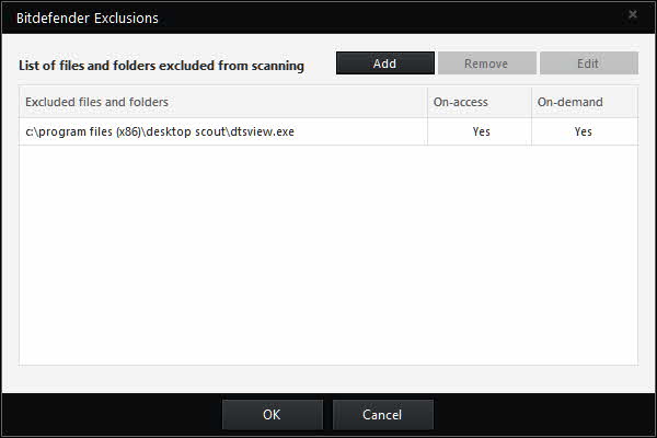

I do not have dtsview.exe set under "Excluded processes". I have no excluded processes configured at all. I have the full path to dtsview.exe set under "Excluded files and folders".
The quoted part of the manual (i.e. "Process exclusions also apply to the Intrusion Detection System included in the Bitdefender firewall.") is from the part titled "Managing excluded processes", not excluded files and folders. The part of the manual that discusses excluded files and folders says nothing about the IDS and/or firewall, only the antivirus component.0 -
