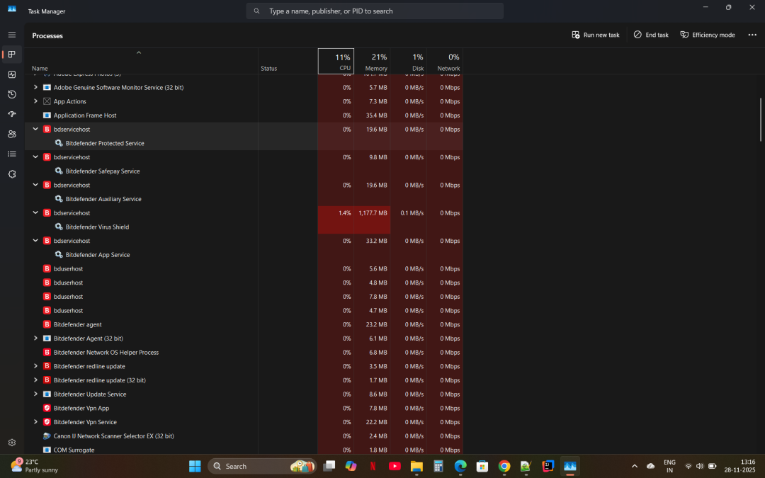

Avoid Bitdefender, as it's acting up. It slowly consumes RAM from my Windows 11 through bdservicehost until the computer freezes and crashes. I have a 16GB machine, and it will take about an hour. According to Bitdefender:

Welcome to the Bitdefender Forums. There have been scattered reports over the years of excessive memory usage, but I have never experienced it, nor is it very widespread. Normally Bitdefender will use about 600 to 800 MB of RAM, except when scanning. I just checked my Task Manager, and all of its processes are using about 700 MB. My computer has been on for five hours.
Often the issue is the particular configuration of a user's computer that is responsible. I recommend working with the support engineers by providing whatever logs are requested.

I guess eating 10G+ is not normal. I turned off scanning except for C: drive & scan apps only. Just in case of 'user config' is a potential cause, I just booted the computer & left it on the login screen. So, the unlikely config is the issue.

I've been reading the conversations about the rising memory usage. If the technicians can't reproduce the issue, here's a tip. My computer was experiencing the same issue, and when I stopped my P2P client, the memory usage stopped rising. Maybe it's worth giving it a shot.

qBittorrent v4.6.2 is the program and 200+ task in it.

Were NOT using qbittorrent at the time. Just leaving W11 as boot-up w/o apps will do it.
0 -
Without qbittorrent, bdservicehost using ~500MB ram. If I started the qbittorent, the memory usage is slightly rising all the time. I don't notice this consmption any other program or services.
0 -
I can confirm the same behavior wit qbittorrent, in similar conditions: qbitorrent v4.6.4 (previous ver. too), win 11 machine (can provide additional details in private, maybe some tests).

We are aware of this issue (it has been reproduced internally), and a fix will be included in a future update.
