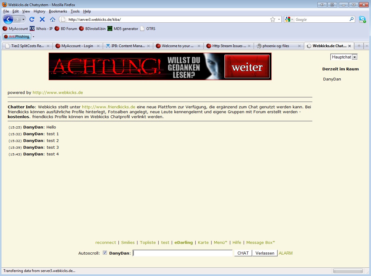

    I have tested both pages as follows:
    1. http://server3.webkicks.de/kiba/
    On my Bitdefender system I can only see a white page until I log out
    - what should I see ? Check the first screenshot
    2. http://www.wolfspirit.eu/test2.php
    - I can see all lines one after another until it gets to 100 when the test is complete.
    I created a ticket on your behalf with the ID: 201011271015923. Check your email and provide me with the requested details on how to further proceed.
