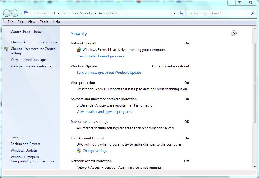

    I experienced the issue you described and also followed the instructions that Mihaela M. posted. After performing the steps in KB814 and rebooting, the issue returned as you described.
    I tried one additional step which so far has held through 2 reboots. After rebooting in the last step of the KB article, I opened the Windows Action Center and then opened the BD Dashboard, went to the Antivirus tab and disabled real-time protection. I left it disabled for about 30 seconds, re-opened BD Dashboard and enabled real-time protection. As soon as I did that, the Windows Action Center reported BD running and up to date. It seems that it took toggling real-time protection for Windows Action Center to detect the change in BD status.
    Here is a current screen shot of my Windows Action Center:
    Try it and let us know if it resolved the problem.
