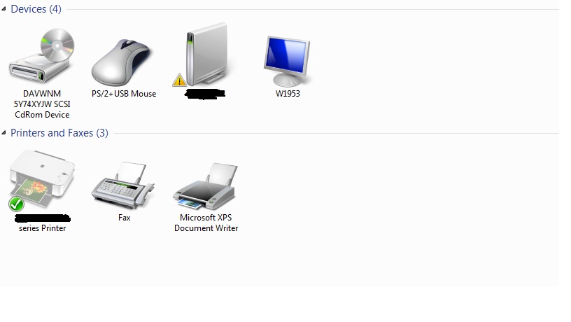

  • i have same problem with bitdefender internet security 2012 .. avc hv bitdefender not found driver ..

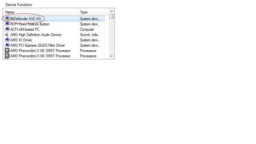

    I found same problem on my computer.
    Bitdefender AVC HV could not load driver software. <_<

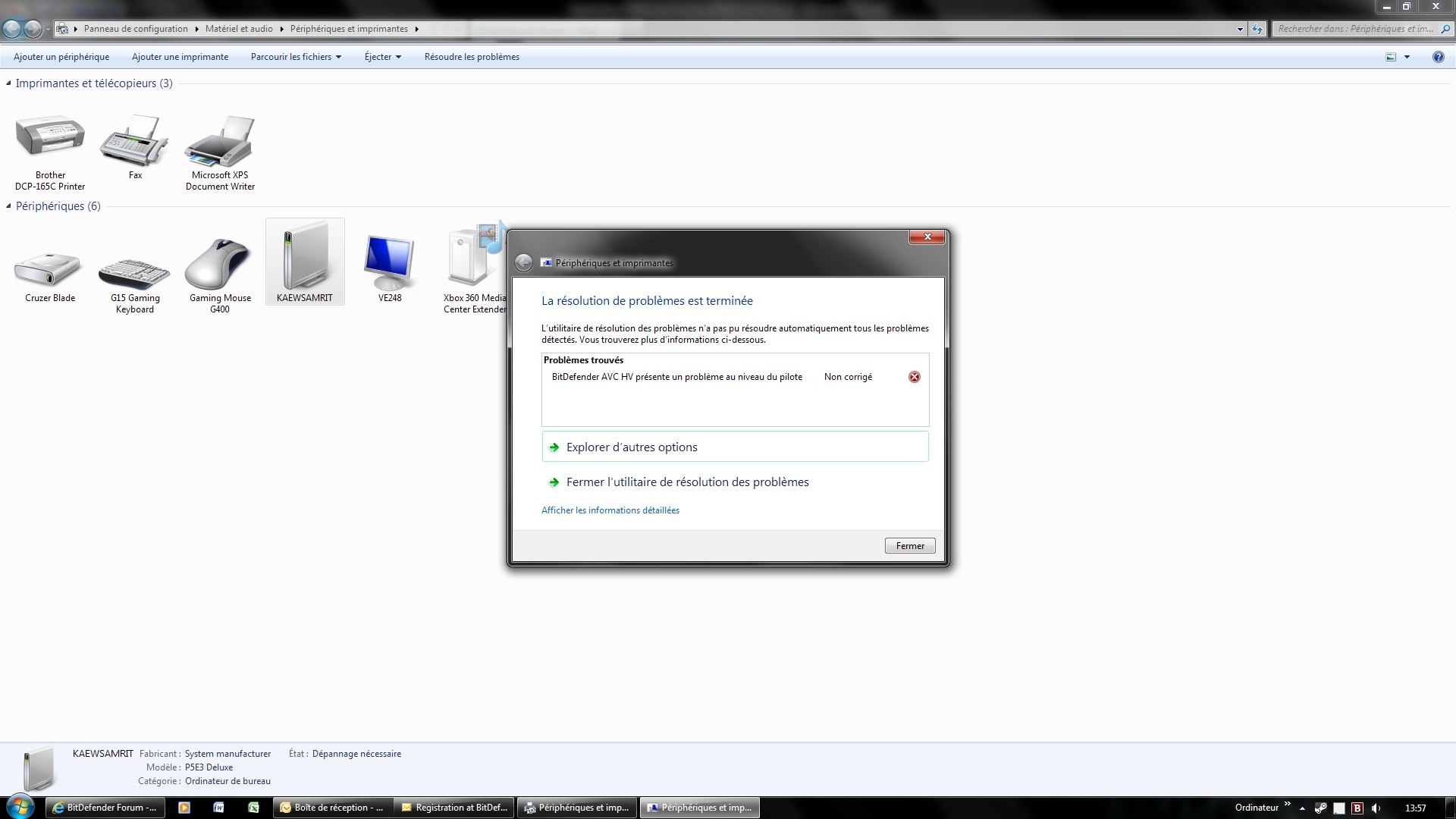

    I'm also having issue with BitDefender AVC HV.
    I unfortunately have to admit I'm aligned with Jack, I have been very disappointed by BitDefender support.... 3-4 days to answer you to reinstall while you specified you did it, and another 3-4 days for another answer... let's say, they just don;t care that you are having an issue. Important thing is, it's not 3 days to answer, it's 3 days between every answer!!!!! I'm sorry if it makes you hungry or anything but that really does not meet my expectations in term of support, and I'm sure I'm not alone... will probably review my choice for my next licence, after 6 years of BitDefender usage...
    The issue:
    I ran the device driver update tool in win7, I saw that there was a driver having an issue, win7 proposed to fix it but was unable. I don't know what this driver is related to, the only thing I know is the driver seems not to work.
    Please help.
