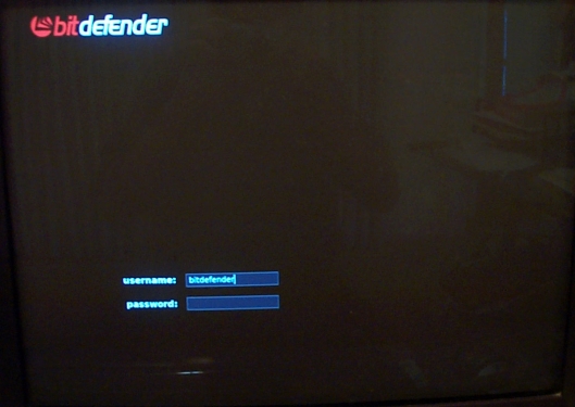

  • Hello Christian,
    Interesting. I wonder what would explain this anomaly. Attached is a photo of the login prompt. Whaddaya make of it?
    I'll have to try it on a different PC when I have the time. The PC I was trying to use it on is a P4 2.4 Ghz Dell with 256 Mb of RAM. Out of 6 different Rescue CDs, only 2 would run with that little memory -- yours and Kaspersky. I don't know what memory would have to do with the logon prompt but right now it's the only variable I can think of. At any rate, thanks for your help, Christian.
    Regards,
    Paul
    Hello :)
    As you can see, that Rescue CD is old, the old logo is present on the left corner.
    Are you sure that you have burned today this file on a blank CD?
    http://download.bitdefender.com/rescue_cd/...r-rescue-cd.iso
    Take care.
